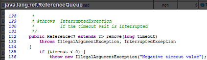

    • added: links to view java source from errors and threads stack-traces. (e5263bf)
    • Source from the JDK and source from artifacts built by Maven and available in Maven central can be viewed. So if your server uses a JRE and not a JDK, source from the JDK are not available. And note that many artifacts available in Maven central were not built by Maven, for example Tomcat libraries, so sources of those artifacts can't be located.
